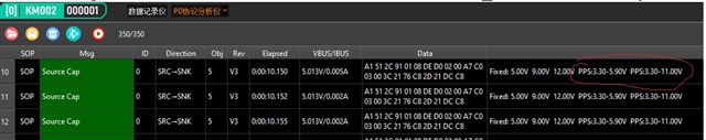

From datasheet of them, both TPS25750 and TPS25751 can compliant with PD3.0. Do they support PPS listed in below PD logs?

The TPS25751 only supports PPS source and sink within a 5V to 21V range according to PD 3.1 specification and is enabled through the Application Customization Tool.
See section 9.2.2.1 from the datasheet for more information.
