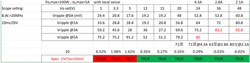

I use the LM5177DCPR to be a adjust power
spec as below:
Vin=24V
Vout=1~48V
Io,max=5A
Po,max=100W
Ripple&Noise expect spec.=1%*Vo+10mV
test report as below by owner PCB board, ripple is over spec, did you have any issue to reduce the noise?
or May I know the evb test result by TI?
Vout 1~5v, output current 1~3A
