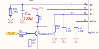

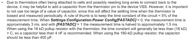

    Also, I would like to ask, what is the recommended capacitance value when using the 18K model? Is 100pf okay?
    quincey
  • Hello Quincey,
    Glad that was figured out!
    Yes, 100-pF is perfectly okay. When using the 18-kOhm pull-up, it is recommended to keep this capacitance below 4-nF, see excerpt from datasheet below:
