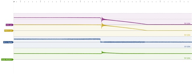

Everything is working fine with a discharge current of 70A. However, discharge MOSFET is getting short during direct load short circuit test.

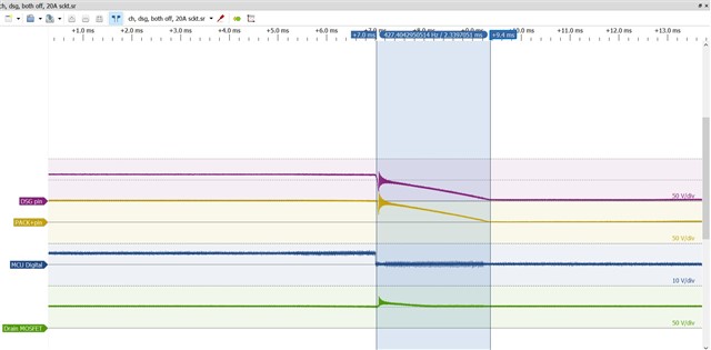

We tried to capture the waveform during a 40A short circuit test. Here MOSFET is not failing but we are observing some ringing oscillations at Source and gate of Discharge Mosfet which might be the reason behind MOSFET damage during Load short circuit.
As per Datasheet and application notes , turn off is carried out in 2 phases.
1. 1st phase -  DSG pin is pull down to Source(PACK+) voltage With RC time contact depending upon Rdsg resistor. ( For our circuit, 12 uS -  is happening within 22uS as per waveforms captured on oscilloscope)
Rdsg is 200 ohm with seperate ferrite bead for each MOSFET. I tried changing Rdsg but it had no effect on oscillation, only the initial delay is changing.
2. Dsg pin and Pack+ fall down to 0/Pack- -  During this period there are some oscillations on DSG pin and PACK+ . DSG is following PACK+ . This period is getting delayed. PACK= is falling down to 0 after 4mS. We doubt this is preventing the MOSFET from turn off and current is still flowing.
( Oscilloscope waveforms are attached during 40A short circuit test)

  • Hello Monica,
    I see from the schematic that a lot of components are DNP, did you populate them during this test (D8/D7/R35)? All of these are recommended components to have for this device.
    I would agree that the parasitic oscillations may be causing the FET failure. We have a good FAQ E2E post we refer to, when talking about FET failures:
    Could you get the gate-source voltage of the FET as well? You could use the MATH function of your oscilloscope to subtract the source voltage from the gate of the DSG FET.
    Is the ferrite bead chosen targeting oscillation frequency? The beads should ideally have its highest impedance at the frequency of oscillation.
    In the past we ran into oscillation issues as well, which were fixed after we added a small capacitor to the drain-gate of the DSG FET. Shown in Figure 6. DSG FET With Added Cgd of the FET Configurations for the bq76200 High-Side N-Channel FET Driver application note. This is highly system-dependent, so it may not work for you, but it may be worth trying out.

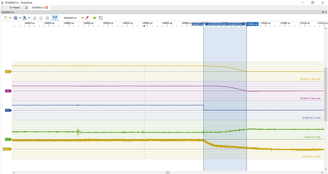

  • Initially, we were performing test with Battery cycler. Then we connected pure resistive load. We observed that oscillations and delayed completely removed with resistive load. So that oscillation problem is resolved now. It was due to cycler load.
    However, During continuous short circuit test (load directly shorted by contacted), Discharge Mosfet is damaging. We could see IC tried to pull down Gate voltage and Pack+ go to negative but then again Pack+ rises and Mosfet and fuse getting damaged.
    Attaching Oscilloscope snaps(pink - DSG, DSG enable, yellow Pack+, green current). With MCU, Current is detected within 200 us. From Bq76200- Calculated dsg fall time is 5 us but it is taking some 100uS.
  • Hello Monica,
    That would go back to the FAQ post I shared above:
    Now we can rule out the oscillations (Glad to hear that was figured out!).
    Due to inductances on traces/loads or battery, there can be high voltage transients during the turn-off of the FET, if the spike is too large, it is possible to exceed the drain-source ratings of the MOSFET.
    It is also possible that discharge is too slow, and depending on the SOA of the FET and how long does it remain in its linear region, if it cannot handle the current during the turn-off, the MOSFET could break.
    Finding the right balance on turn-on/off is what we probably need to figure out here. If turn-off is too slow, you can decrease the DSG resistor.

  • As you rightly said,
    1. I tried to change Rdsg till 10 ohm. The graphs provided here are wrt Rdsg=10 ohm.
    2. In order to operate Mosfet in SOA wrt shorct circuit, I need to increase number of MOSFETs in parallel in Discharge circuit?
    3. Vds limit for selected MOSFET is 100V and we observed it is less than limit during testing. What is the way to limit oscillations during switching? I have connected capacitors and TVS diode at Pack+. I tried to add snubber circuit as well but no change in oscillations.
    Request your suggestions?
  • Hello Monica,
    If the FET is breaking due to it not being able to handle the current then yes, I think the only solutions would be to either:
    1. Add more MOSFETs in parallel to increase their current capabilities
      1. Which actually, would also slow down the turn-off as well, so maybe it won't be too great, if the turn-off speed is what's causing problems.
    2. Increase the turn-off speed further by using external circuitry.
      1. There are many turn-off circuits that can be used. A typical local turn-off circuit we have used and see often used is a BJT local turn-off circuit. Which we show/describe in Section 5 Parallel FET Test Circuits of the Multiple FETs with the BQ76952, BQ76942 Battery Monitors application not, which although is for a different part, this concept still applies.
      2. Remember, if turn-off is too fast, then the voltage transients can be cause damage.

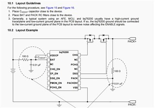

    Oscillations usually can be handled in a few different ways, one is to have a ferrite bead (FB) on each individual FET gate (Which I already know you have), the FBs would ideally dampen the oscillation by having a high impedance at the oscillation frequency, that is why it is important to choose a FB that will target it.
    Another way is to have a fixed resistor instead of the FBs, which will dampen the oscillations, but in turn would also slow down your switching speed somewhat, as the resistance will always be there at any frequency. You could try testing while having a fixed resistor here.
    Another thing that would help, is to have good layout practices to reduce parasitic components as much as possible. Matched gate traces, small turn-off loops, design traces for low inductance. All of these would help prevent for oscillations. Even the FET selection would be good, FETs with smaller differences in the gate-source threshold voltages would also be less susceptible to the effects of oscillations.
    I actually touch on this topic a couple years ago in our yearly live BMS Seminar, here is the PDF of this presentation:http://www.ti.com/lit/SLYP856
    I linked to some app notes that aid in the design of MOSFET layouts and circuits. I describe turn-off circuits here as well and the resources here also have explanation on those.

    One more thing observed during testing, within 50 us Pack+ (source of discharge MOSFET) and and Gate is reaching to zero and current is zero. MOSFET is safe also.
    But somehow, Pack+ is again rising to BAT+ and gate is following again. However current is zero in this case so MOSFET must be off. But I am not able to understand Why PACK + is again rising after coming to Zero. Does Cf and Rf connected at pack+ cause issue? I have selected the lowest value recommended in datasheet. What can cause PACK+ to rise again as there is no other capacitor than cf.

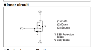

    There is something I just noticed. The Q3 drawing seems to be incorrect, the body-diode is backwards, correct? If the body-diode of the FET is correct there, it would mean the diode bypasses the DSG FET.
    Now for your new question, is there a load attached during the time PACK+ rises?
    If it rises temporarily after it goes low, this is likely due to the transient I described earlier. Now, if it is a more constant value, it may just be leakage currents causing it to rise in voltage.

  • 1. That is precharge MOSFET.  It is symbol mistake but in actual it is reverse. Using RD3P130SP in circuit, Diode is propely connected.

    You should not remove the Cf capacitor. I do not believe either Rf or Cf would cause this problem. You can see waveform examples of how Rf/Cf can affect the turn-off of the DSG FET in the bq76200 Beyond the Simple Application Schematic application note.
    It may be a voltage transient due to board/load parasitics after the FET turn-off. I would imagine that slowing down the turn-off speed would cause that PACK+ transient voltage to decrease.
