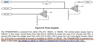

    In that case, I would like to know what would be the efficiency since if VBUS=15v and an internal LDO generates from it 3.3v than it seems quite a lot heat dissipation inside the chip. What is the current limitation on the 3.3v in that case ?

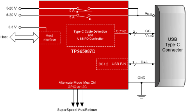

    And another question - where does the 5v for USB base connection comes from ? Does it need to be supplied externally as seems in the EVM block diagram ?
    Or is it generated internally in the chip form VBUS voltage which can be up to 20v  ?
    According to datasheet, it doesn't seem there is a special input for 5v in the pinouts. There is only PPHV1/2 that can be up to 20v :

    2-  The TPS65987DDK supports booting from no-battery or dead-battery conditions by receiving power from VBUS (this would be the case where VIN3V3 is not present as described below).

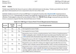

    3- PP_Cable is the input to power VCONN output on C_CC pins. VCONN is provided by the source to power cables with electronics in the plug. Please see below from the USB Type-C specification on when VCONN is required (this may or may not be applicable to your design)
    Could you provide more insight on your design? Do you require the support of any alternate modes, such as DisplayPort?

    2. The core digital circuitry is powered up from VIN3V3, and is required. The only scenario in which the device is powered from VBUS, is in dead-battery mode, which is not applicable in your design from my understanding.

    Regard 3 - That is not mentioned anywhere in the data-sheet. Not in the power management, not in the pinout configuration:
    and even not in the simplified schematic:
    The only power inputs mentioned are PPHV1 and PPHV2 which are both can be up to 20v. Ni specific 5v input is mentioned.

    Just to clarify, the 5-V input (PP_CABLE) is only required if your system needs to source VCONN to power cables with electronics in the plug (this is typically required when the current capability>3A). This is not needed for all systems.
    See Section 6.5 Power Supply Requirements and Characteristics below:

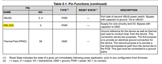

    I have found mismatch in datasheet regard 3 pins in datasheet, They are defined differently in two pages:
    Name (In Page 3)
    Name (In Page 4)
    Pin Number
    GND
    C2_CC1
    45
    GND
    PP2_CABLE
    46
    GND
    C2_CC2
    47
    Please tell which is the right pin naming ?
    Ohad
  • Hi Ohad,
    Figure 5-1 on page 3 is imported from the TPS65988 datasheet (dual-port device). We are working on updating the pinout naming in the TPS65987DK datasheet.
    For the TPS65987DK, please use the naming and pin functions that are stated in Table 5-1.
