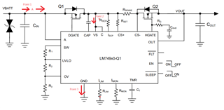

Hi Application Team:
   I have one questions of LM74910-Q1 Quiescent current measure point .
May I know I(GND) current  measurement were which point of the follow current flow .
Is Point 1 ? or Point 2 or Point 3 to get SHDN , SLEEP quiescent current (IGND)?  thank you
