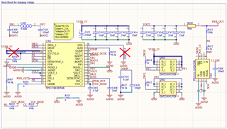

Hi, I am using the TPS552882RPMR DCDC to generate 4-20V from a 5V USB source.
Everything goes fine from 20V to around 7V, then the output starts to oscillate in the acoustic range (+-2V )
This is the design:
I appreciate a lot your help.
