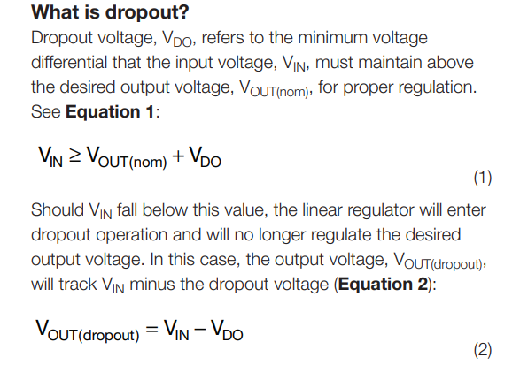

  • Hi Hannah,
    Vin needs to be at least 1.5V higher than Vout for the part to align with datasheet specifications on features such as PSRR, noise reduction, etc...
    Understood on having a headroom is required to be within the datasheet.
    My question was outside of datasheet, what happens when the Vin is below Vout? Will you see Vin - (internal FET Ron * Iout) = Vout for the output?
    I understand PSRR and other filtering are not guaranteed at all at this point.
    I am trying to understand the IC's output behavior in "Vout + headroom value"(specified in datasheet) > "below headroom" > Vin > "Vin UVLO".
    Luke
  • Hi Luke,
    Please see LDO Basics (Rev. A) (ti.com) for more information on dropout.
    Hannah
