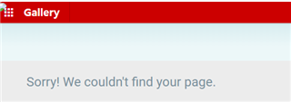

  • Hi, Ishtiaque
    I tried clicking on the updated GUI link you provided, but I don't see any data.
    Even if you search in the Gallery, you can only find up to 3.0.0 as shown below.
    Please check again.
  • Hi Grady Lee,
    Sorry that was internal link. Use below one and check.
    https://dev.ti.com/gallery/view/PMIC/Scalable_PMICs_GUI/ver/4.0.0/
    BR,
    Ishtiaque

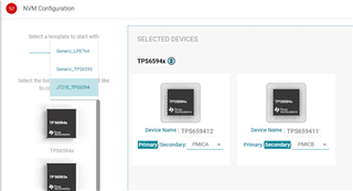

  • Hello, this is the customer for this question.
    Then, which part of the NVMs of each EVB should be updated to verify the Multi-PMIC synchronization behavior using the PMIC EVB 1 & 2 (LP87644Q1EVM 2 set)?
    Can you provide me with an example NVM configuration that I can refer to?
    Other features are not very relevant, just check the Multi-PMIC synchronization function.

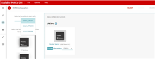

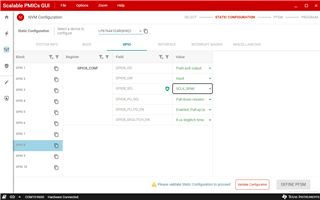

  • Hi Won,
    Well, you need to create new NVM combo with GUI using 2xLP8764-Q1 devices and this way internal bits for SPMI are set correctly. There is no manual control over those bits for a reason that confusion is very obvious. Setting bits with GUI works always correctly.
    For example you can select for fist device template for LP87644Q1EVM device and add secondary device as LP8764-Q1 from left.
    GPIO8/GPIO9 needs to changed. for both devices Also secondary device needs some power sequence if you want to run BUCKs for example.
    From TPS6594-Q1 dual config you can find some hints i think for configs.
    Br, Jari

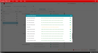

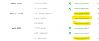

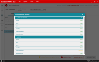

  • Thank you for your response.
    The process you told me was carried out through the GUI.
    However, the NVM program for the secondary PMIC has not been created since then.
    The NVM validation of the secondary PMIC fails as shown in the attached figure during the NVM configuration, and the program cannot be created.
    For the secondary PMIC NVM, the WD_MASK bit cannot be set, but the validation seems to fail because it checks whether the WD_MASK bit is set or not.
    (For the primary PMIC, the NVM validation is successful.)
    In this regard, our inquiries are as follows.
    - Is there anything else I missed or need to check additionally?
    - Do I need GUI update for NVM update? (I'm currently using GUI 4.0.0)
    - Can I just proceed with the Primary PMIC NVM configuration for 2 boards without the Secondary PMIC NVM configuration?
    - Can you provide an NVM program with Multi-PMIC synchronization for LP87644Q1EVM?
      If it is difficult to disclose on the web, please contact the contact information below.
       yjwon@hyvision.co.kr
  • Hi Won,
    Not sure how it is being done but WD_MASK warning shown is do not care. Have you programmed both PMICs? Can you share the json file.

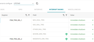

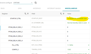

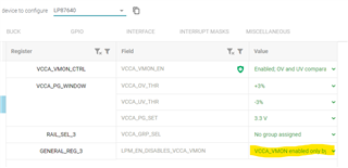

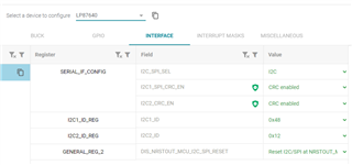

  • Hi Won,
    For secondary PMICB I2C1 and I2C2 addresses have to different than for PMICA
    Also triggers for state machine must be per PMICA for PMICB.
    Would mask following for PMICB since PMICA controls power-up/down through SPMI.
    Would match startup_dest to be same in PMICB as in PMICA.
    Match to PMICA on PMICB
    Br, Jari
