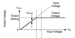

Secondly, this IC seems to have special feature "7.4.3.5 Dropout", where even when the Vin is below Vout, it will try to follow the Vin value, described by the below picture.
1. Assuming we are operating above minimum Vin, for example, 20V and creeping down to 5V, where set voltage Vout=10V. How should one can calculate the VDROP described in this picture. My understanding is that at this point the DCDC operates at max duty cycle 98%, Rds on for HS and LS, series inductance should be playing a role, but it is not mentioned in this section. Can you help me here?
FYI, I am referencing basic DCDC topology described in this old apps note.  https://www.ti.com/lit/an/slyt293/slyt293.pdf?ts=1713319693943&ref_url=https%253A%252F%252Fwww.google.com%252F
2. With minimum Vin being 3V even with external VCC, shouldnt the X-axis cut-off on the left side? It seems like Vout will follow the Vin to 0V. I think it will "shut down" at some point.
Frankly speaking, i am trying to calculate this shut down cut voltage, but it is related to above question.

  • Hi Luke,
    VCC upon regulating is at 3.15V, so it is lower than the minimum input voltage upon startup.
    Yes, you can use that equation to estimate the dropout losses. From other parts, we expect about 0.2V for no load, and maybe up to a 1-V drop if operating at max load.
    2. Yes, that is a good catch, but this graph was meant to showcase dropout operation. The part should shut down at 3.35V worst case, but in a typical case, it should match the 3V minimum input voltage.
