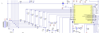

2. Regarding the External balancing, I am currently using the following schematic which is present in the TRM, even the 7S part which is not necessary.
My problem with this setup is that whenever I populate the mosfets and switch from internal balancing to external balancing, the cell voltages reading gets affected. For example if all the cells are at 3.8V, some would read 1.7V but some would read greater than 5 volts. I tried the same circuit on two boards and the results were more or less the same. In one of the boards, removing the mosfets and switching back to internal balancing would bring back the cell voltage readings back to normal. But on the other board, the cell voltage readings remain to be incorrect even after removing the mosfets and turning cell balancing off(I think this board might have been damaged).
In the forum, I have come across some posts where it is said that capacitors should be placed between the Vcx inputs and not from Vcx to ground. Is that something which would help my case? If not, have you guys come across any similar case, and have any tips for me? Hoping to hear from your team soon.
    Regarding the capacitors, I believe they should be implemented between the VCx inputs. Below is the bq40z80EVM where they are configured in this orientation as well.
    Please let me know if this is able to alleviate this issue.

     I will get back to you regarding the external cell balancing circuit after testing it out. Is there a reason there is a disparity in the circuit provided for cell balancing in the TRM and the EVM's datasheet?

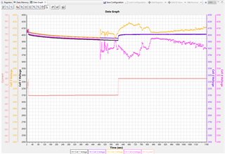

    I tried implementing the new setup with some changes on my PCB. Since my battery was at full capacity, I tried to discharge it, I do not have the logs but was monitoring using the graph.
    Note, that the cell balancing was turned off and all of the cells are at similar voltages if measured with the help of a multimeter, but the gauge reads the voltage differently. Any idea what could be causing this?
    Can you please tell me how different the voltages being reported from the multimeter are compared to the gauge? The gauge has a voltage calibration function that can be implemented if there are different voltages being reported.

  • The voltages on the cell right now are 4059,4057,4058,4057. The following are the voltages I read between
    Gnd and VC1 2206
    VC1 and VC2 8293
    VC2 and VC3 0010
    VC3 and VC4 5663
  • Hi Bhavil,
    That seems like an extreme difference from the gauge and the multimeter. Is it possible to share a quick log from bqStudio of the gauge so we can take a deeper look?
    Also, if you would like to share your schematic of this PCB we can take a look at that as well.
    Anthony Baldino
