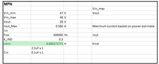

We chosen LMR51610 for an wireless AP design, below are the input, output requirement.
Vin: 48V
Vout: 28V
Iout : 0.6A
 Fsw : 400KHz
Datasheet formula give us Inductance values of 171uH for above spec.

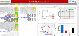

EXCEL TOOL suggesting Inductance value of 68uH.
Could you please clarify why there is huge difference in values?
Also could you please share us unprotected Excel calculation tool, becoz frequently the sheet is struct & not calculating the values as per the input.
