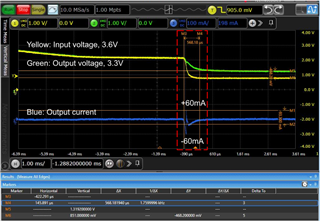

When doing reverse current check, I found that the Vo > Vin +0.3V for few ms. Thus, I probe the output current to check any reverse current issue.
Question:
1. Is the red box showing reverse current happened once Vo > Vin + 0.3V? If no, what is the correct way to check reverse current?
2. Datasheet shows that external limiting to 5% of the rated output current is recommended. Mean we have to make sure the reverse current spike < 0.05 x 200mA = 10mA during LDO shutting down? Any timing spec?
3. Any proposal for the external limiting current circuit?
