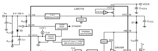

    Here are two questions.
1. The pin description of VCCx is different from the block diagram.
2. Could you pls help explain DEMB function? Thanks.

  • Hello Skylar
    1. Would you please tell us the difference you are thinking about ?
    2. Diode emulation mode control pin . The inductor current is sensed by monitoring the voltage between SW and DEMB. As the SS capacitor continues to charge beyond 1.215 V to 3 V, the DEMB bias current will increase from 0 µA up to 40 µA. With the use of an external DEMB resistor (RDEMB), the current sense threshold for diode emulation will increase resulting in the gradual transition to synchronous operation.

  • Hi Eric,
        From the block diagram, it means if VCCX< 4.5V, the mosfet will turn on and then VCCX is internally connected to VCC. But the pin description is different. Could you pls help it? Thanks.
    BR,
    Skylar
  • Hello Skylar
    P-Channel MOSFET turns on when the gate is pulled down. Which means the switch connecting VCCX to VCC will turn on when the 4.5V comparator output is in low logic state.
