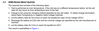

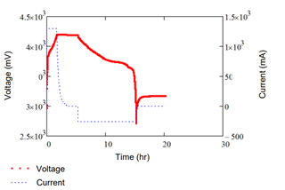

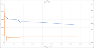

Hello, Im planning on using the BQ34Z100 fuel gauge in a new system design. I currently have a BZ34Z100EVM board that I have been able to update the software and have everything working. Voltage and current are calibrated and look good so I can start logging data to get proper checm.. Do I need battery temp info in the log file to get proper Chem?
