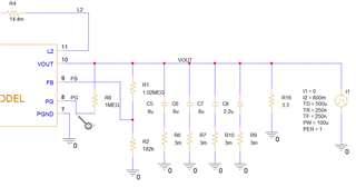

TPS63021: Confirmation request regarding simulation waveform of PG output
Part Number: TPS63021
Dear Specialists,

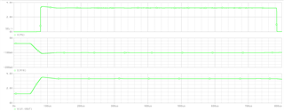

Regarding the simulation waveform of related thread, the customer has an additional question.
I would be grateful if you could advise.
ーーーQuestion
Regarding waveform, when L⇒H, it rises steeply, and when H⇒L, it falls slowly. (square red flame)
I would like to check the circuit because it is the opposite of my understanding.
(My understanding is that in the case of an open drain, it rises slowly when L⇒H, and falls sharply when H⇒L.)
Could you please answer following two questions?
①What kind of connection of the PG terminal was used in the simulation?
Is it pulled up? What is its resistance value? etc.
②The open drain circuit of the PG terminal is considered to be an attached circuit
I appreciate your great help in advance.
