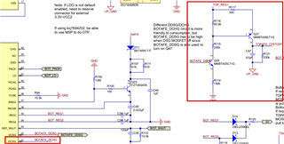

      1.The customer has designed a logic circuit, so that both AFEs can directly control the FET, the circuit is as follows, whether it is feasible?

  • Hello User,
    They should analyze the circuit thoroughly to ensure it will work. However, not sure how well it will work. If they can explain their thought process that'd be good. For the CHG FET I don't quite see how M16 may be able to turn-off correctly. The M16 looks to me that it may be floating regardless of the state of the bottom driver.
    For the DSG FET it is even more complicated, as the DSG source voltage (PACK+) may be able to drop all the way to Vss. This means that there will need to be circuitry to allow the source to drop that low and protect the DSG/LD pins of the top AFE.
    The TIDA-010247 adds circuitry to achieve that.
    Controlling the FETs with the CFETOFF/DFETOFF pins would achieve the same thing that this circuit, but much easily so. Is there a reason why they do not want to use the CFETOFF/DFETOFF pins?
