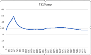

    While looking into the past test data you sent as well, I see that the temperature reading is getting to a very high value (almost 50 degrees C). Can you give more detail into what is occurring at that time? Many calculations take temperature into account, which could also be causing an issue with the gauge.
    Anthony Baldino
    I couldn't find any data close to 50 ° C from obtaining chemical ID 7583 and learning data, with a maximum temperature of 30 ° C. If it refers to the test data I initially asked, the temperature reaching 50 ° C is due to my use of 6A current for discharge at room temperature, and the temperature rise of the battery meets the specifications of the battery cell. If there is any problem, is there an error in selecting the chemical ID? I have learned again with load mode set to 0 and load select set to 7. Please check the attached data for any abnormalities. I have written the exported gg.csv file to another battery, and after sending the reset command, the FCC is 2828mAh, and the health rate is only 94%. This is inconsistent with the actual charging and discharging capacity during the learning process. Please help me find the problem. Thank you!load_mode_0.zip
  • Hi Ian,
    Below is the temperature reading from TS1 from the test data earlier sent:
    I believe for the chemID, this should be fine since the instructions have been followed for the inputted data to the GPCCHEM tool.

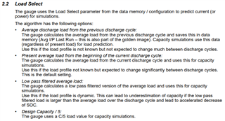

    If possible, can you please tell me more about the load of the application? This will allow us to get a better idea of how to set the load select.
    How much is the load changing between discharge cycles?
    Anthony Baldino
    My usage scenario is applied to drones, with a discharge current of around 600mA before takeoff, a discharge current of around 5000mA during takeoff hovering, an average of 12000mA during rapid flight, and a peak current close to 16000mA. This is the usage situation on the product. At present, I am using 1500mA current charging and 6000mA discharge for testing after completing my studies. The test result shows that the FCC update is relatively small. Although calculating the discharge capacity of SOC to 0% is correct, the voltage has not reached the cut-off voltage. Continuing to discharge until the cut-off voltage can release the battery cell's specification capacity. So, what is the reason for estimating that more capacity cannot be released?
  • Hi Ian,
    Thank you for explaining, below is the descriptions of each of the Load Select options:
    I believe the second option "Present average load from the beginning of current discharge cycle" should be tested based on the description given above.
    Also, for load select/load mode changes, the entire cell does not need to be relearned. These parameters can be changed, then running a few charge/relax/discharge/relax cycles should be able to show the difference.
    In the sent files, Term Voltage is set to 5400mV, and within the log file the voltage reading does reach this. This is also represented if you look into the individual cell voltages where the both of them become less then 2700mV.
    Based on the table below, it also seems like the gauge is seeing the correct amount of passed charge, since the design capacity for this cell is 3000mAh.
