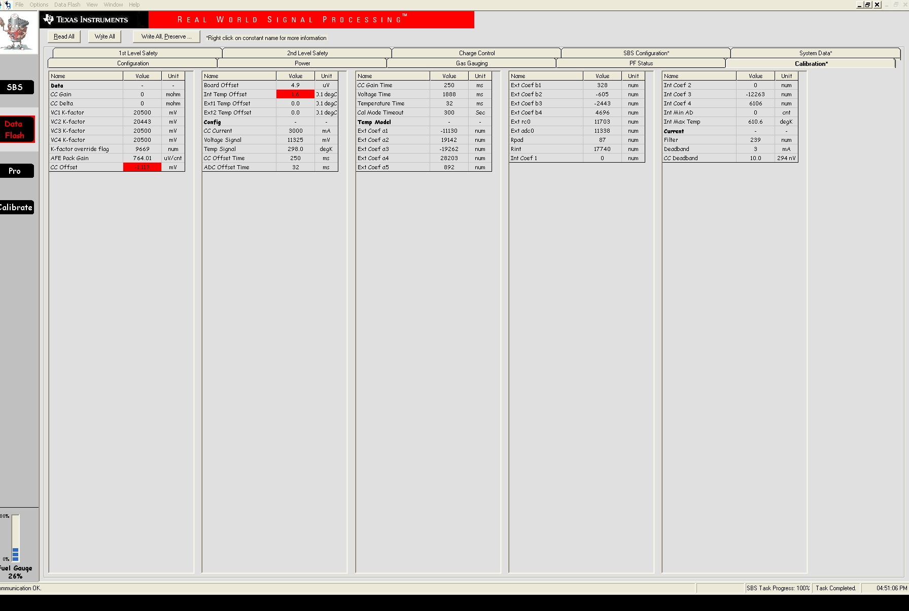

On our first batch of new batteries from our contract manufacturer we're finding nearly 100% have the "CC Gain" and "CC Delta" both set to 0. This does not correspond to our golden file. All other parameters match the golden file. We are unable to replicate it here.
We will be visiting to observe their procedure for programming and calibrating the batteries. In the meantime, do you have any ideas of how this might be happening?
I have attached the .gg file (uploaded as .txt since the forum won't accept .gg) and relevant screenshots from the bqEVSW software.

[Data(Calibration)]
CC Gain = 0
CC Delta = 0
VC1 K-factor = 20500
VC2 K-factor = 20443
VC3 K-factor = 20500
VC4 K-factor = 20500
K-factor override flag = 9669
AFE Pack Gain = 764.01
CC Offset = -1.273
Board Offset = 4.9
Int Temp Offset = 1.7
Ext1 Temp Offset = 0.0
Ext2 Temp Offset = 0.0

    This sounds like a problem during calibration. Perhaps there isn't any current flowing when the gauge thinks there should be 2A, so it's trying to correct for this. Make sure that the values entered for voltage and current during calibration are accurate. I imagine there will be some discrepancy like that when you visit their site.
    Jason
  • Thank you Jason.
    I'm a bit unclear on where exactly the current calibration info is stored (is it in the dataflash or elsewhere? I have not found parameters that seemed right in the dataflash), but from the testing I have done, if such an error is made during calibration we will end up with much bigger issues (overcurrent, followed by DFETF or CFETF failures). The packs we have are measuring current just fine, so I believe they are calibrating them correctly.
  • All calibration data is stored in under the Calibration tab.
    Having 0 on the CC Gain and CC delta indicated the device sense no current (or a very small) during current calibration. Once you have 0 on these calibration value, your current measurement will mess up and you will end up with various current fault.
    To recover from this point, you can reprogram the CC Gain and CC delta to 10 (which is the default value).
    If you have a PF, the device will not allow you to update the data flash. In that case, you can
    1) re-program the device with default senc file and start over.
    2) apply current to the pcb to "offset" the flash current reading, and then send a PF clear cmd to clear the PF condition. Now you can rewrite the CC Gain/Delta value.
    To do current calibration, we recommend to apply the current across PACK- and CELL-. This will force the current directly to the sense resistor and it is more accurate for calibration.
    Even with an uncalibrated device, you should see the SBS.current reporting a fairly close value to the actual current. If SBS.current is way off, then you SHOULD NOT run the current calibration and should check your hardware setup. Otherwise, you will end up with a very small CC Gain/delta again.
    Note: You should also run CC offset and board offset calibration before current calibration.
