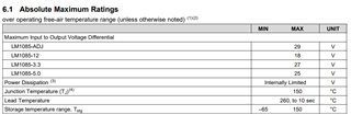

  • Hi Juliette,
     tks for the comments here .  for further check , we found the Vin abs is for Maximum Input to Output Voltage Differential
     what if 15V/1A output, the differential is 29V, does it means the Vin can cover to 15+29V?
    better to share with us what`s Vin abs here for clear understanding.
  • Hey Allen,
    Because this part doesn't have a GND pin, and instead has an ADJ pin, we cannot give an abs MAX for VIN.
    The Maximum Voltage differential would be limited by the thermals/power dissipation across the die.
    If VIN -VOUT = 29V, and your load is 1A, your power dissipation is 29W.
    With a Theta-JA of 50C/W
    Your Junction rise would be, approximately:
    TJ ~ TA + 1450C
    This is considerably above what the part is rated for and will not work.
    You typically want to keep the power dissipation across a device less than 2W, depending on the Theta-JA
    Juliette

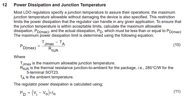

  • Hi Juliette,
     tks here.
     regarding to LM1085IT-ADJ/NOPB  with below formula, can you help to check why 50C/W and how comes with 1450C?
    TJ ~ TA + 1450C
  • I am calculating for TJMAX.
