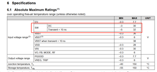

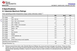

TPS53515: should Vin-SW also follow SW pin requirement
Part Number: TPS53515
HI,
  SW pin voltage is within datasheet requirement. But Vin-SW minimum voltage exceeds the  SW pin requirement.
These only happen when SW is transitioning from low to high. I would like to know if these over-voltage condition cause damage to the device.

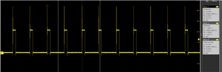

CH4 is VIN-SW tested by differential probe
SW pin wave form
