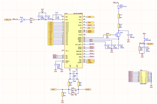

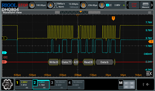

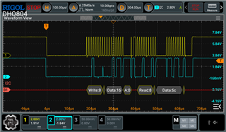

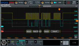

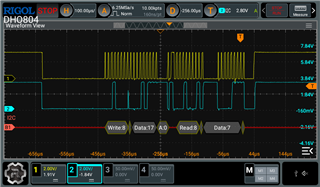

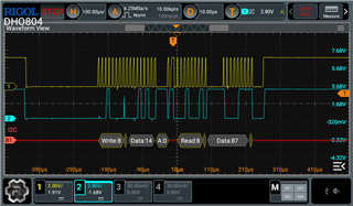

Our team has developed a custom hardware circuit employing the BQ7695202, with communication facilitated through the STM32L433 MCU via I2C.
Regrettably, we are encountering difficulties in reading information from or establishing communication between the BQ7695202 and the MCU.
We kindly request your support in diagnosing the issue and providing recommendations for resolution.
Enclosed is a segment of the schematic for your reference below

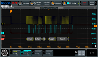

We have 4.7k Pull resistor on SDA and SCL
On hardware we are getting REG18 - 1.8V , REG1 - 3.4V and REG2 - 0V
Please suggest is there any other parameter we can test on hardware?

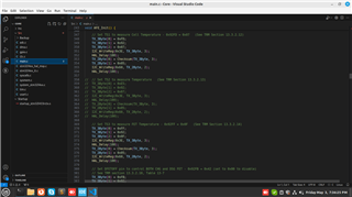

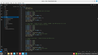

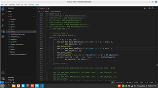

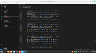

I'm also sharing our STM C file for reference
Also,
When we use 'HAL_I2C_IsDeviceReady' lib function to check device ready, it returns HAL_ERROR

	//  delayUS(1000);
	TX_2Byte[0] = Checksum(TX_3Byte, 3);
	TX_2Byte[1] = 0x05;
	I2C_WriteReg(0x60, TX_2Byte, 2);
	//  delayUS(1000);
	// Enable all protections in 'Enabled Protections B' 0x9262 = 0xF7 (See TRM section 13.3.3.3)
	// Enables OTF (over-temperature FET), OTINT (internal over-temperature), OTD (over-temperature in discharge),
	// OTC (over-temperature in charge), UTINT (internal under-temperature), UTD (under-temperature in discharge), UTC (under-temperature in charge)
	TX_3Byte[0] = 0x62;
	TX_3Byte[1] = 0x92;
	TX_3Byte[2] = 0xF7;
	I2C_WriteReg(0x3E, TX_3Byte, 3);
	//  delayUS(1000);
	TX_2Byte[1] = 0x05;
	//  delayUS(1000);
	// Set TS1 to measure Cell Temperature - 0x92FD = 0x07   (See TRM Section 13.3.2.12)
	TX_3Byte[0] = 0xFD;
	TX_3Byte[1] = 0x92;
	TX_3Byte[2] = 0x07;
	//  delayUS(1000);
	TX_2Byte[1] = 0x05;
	//  delayUS(1000);
	// Set TS3 to measure FET Temperature - 0x92FF = 0x0F   (See TRM Section 13.3.2.14)
	TX_3Byte[0] = 0xFF;
	TX_3Byte[1] = 0x92;
	TX_3Byte[2] = 0x0F;
	//  delayUS(1000);
	TX_2Byte[1] = 0x05;
	//  delayUS(1000);
	// Set DFETOFF pin to control BOTH CHG and DSG FET - 0x92FB = 0x42 (set to 0x00 to disable)
	// See TRM section 13.3.2.10, Table 13-7
	TX_3Byte[0] = 0xFB;
	TX_3Byte[1] = 0x92;
	TX_3Byte[2] = 0x42;
	//  delayUS(1000);
	TX_2Byte[1] = 0x05;
	//  delayUS(1000);
	// Set up Alert Pin - 0x92FC = 0x2A  - See TRM Section 13.3.2.11, Table 13-8
	// This configures the Alert pin to drive high (REG1 voltage) when enabled.
	// Other options available include active-low, drive HiZ, drive using REG18 (1.8V), weak internal pull-up and pull-down
	TX_3Byte[0] = 0xFC;
	TX_3Byte[1] = 0x92;
	TX_3Byte[2] = 0x2A;
	//  delayUS(1000);
	TX_2Byte[1] = 0x05;
	//  delayUS(1000);
	// Set up Cell Balancing Configuration - 0x9335 = 0x03   -  Automated balancing while in Relax or Charge modes
	// See TRM Section 13.3.11. Chapter 10 of TRM describes Cell Balancing in detail
	// Also see "Cell Balancing with BQ76952, BQ76942 Battery Monitors" document on ti.com
	TX_3Byte[0] = 0x35;
	TX_3Byte[1] = 0x93;
	TX_3Byte[2] = 0x03;
	//  delayUS(1000);
	TX_2Byte[1] = 0x05;
	//  delayUS(1000);
	// Set up COV (over-voltage) Threshold - 0x9278 = 0x55 (4301 mV)
	// COV Threshold is this value multiplied by 50.6mV  See TRM section 13.6.2
	TX_3Byte[0] = 0x78;
	TX_3Byte[1] = 0x92;
	TX_3Byte[2] = 0x55;
	//  delayUS(1000);
	TX_2Byte[1] = 0x05;
	//  delayUS(1000);
	// Set up SCD Threshold - 0x9286 = 0x05 (100 mV = 100A across 1mOhm sense resistor)
	// See TRM section 13.6.7    0x05=100mV
	TX_3Byte[0] = 0x86;
	TX_3Byte[1] = 0x92;
	TX_3Byte[2] = 0x05;
	//  delayUS(1000);
	TX_2Byte[1] = 0x05;
	//  delayUS(1000);
	// Set up SCD Delay - 0x9287 = 0x03 (30 us)    See TRM section 13.6.7
	// Units of 15us
	TX_3Byte[0] = 0x87;
	TX_3Byte[1] = 0x92;
	TX_3Byte[2] = 0x03;
	//  delayUS(1000);
	TX_2Byte[1] = 0x05;
	//  delayUS(1000);
	// Set up SCDL Latch Limit to 1 to set SCD recovery only with load removal 0x9295 = 0x01
	// If this is not set, then SCD will recover based on time (SCD Recovery Time parameter).
	// See TRM section 13.6.11.1
	TX_3Byte[0] = 0x95;
	TX_3Byte[1] = 0x92;
	TX_3Byte[2] = 0x01;
	//  delayUS(1000);
	TX_2Byte[1] = 0x05;
	//  delayUS(1000);
	// Exit CONFIGUPDATE mode  - Subcommand 0x0092
	TX_2Byte[0] = 0x92;
	TX_2Byte[1] = 0x00;
	I2C_WriteReg(0x3E, TX_2Byte, 2);
	//  delayUS(1000);
//  ********************************* FET Control Commands  ***************************************
void AFE_FET_ENABLE() {
	// Toggles the FET_EN bit in the Manufacturing Status register. So this command can be used to enable or disable the FETs.
	TX_2Byte[0] = 0x22;
	TX_2Byte[1] = 0x00;
void AFE_FET_Control(uint8_t FET_states) { // Bit3 = PCHG_OFF, Bit 2 = CHG_OFF, Bit1 = PDSG_OFF, Bit 0 = DSG_OFF
	TX_3Byte[0] = 0x97;
	TX_3Byte[1] = 0x00;
	TX_3Byte[2] = FET_states;
	//  delayUS(1000);
	TX_2Byte[1] = 0x05;
void DSG_PDSG_OFF() {
	// Disable discharge (and pre-discharge) FETs
	// Subcommand 0x0093  See TRM Table 5-8  (DSG_PDSG_OFF())
	TX_2Byte[0] = 0x93;
	TX_2Byte[1] = 0x00;
void CHG_PCHG_OFF() {
	// Disable charge (and pre-charge) FETs
	// Subcommand 0x0094  See TRM Table 5-8  (CHG_PCHG_OFF())
	TX_2Byte[0] = 0x94;
	TX_2Byte[1] = 0x00;
void AFE_ALL_FETS_OFF() {
	// Disable all FETs with command 0x0095  See TRM Table 5-8
	TX_2Byte[0] = 0x95;
	TX_2Byte[1] = 0x00;
void AFE_ALL_FETS_ON() {
	// All all FETs to be enabled with command 0x0096  See TRM Table 5-8
	TX_2Byte[0] = 0x96;
	TX_2Byte[1] = 0x00;
void AFE_BOTHOFF() {
	// Disables all FETs using the DFETOFF (BOTHOFF) pin
	HAL_GPIO_WritePin(DFETOFF_GPIO_Port, DFETOFF_Pin, GPIO_PIN_SET); // DFETOFF pin (BOTHOFF) set high
void AFE_RESET_BOTHOFF() {
	// Resets DFETOFF (BOTHOFF) pin
	HAL_GPIO_WritePin(DFETOFF_GPIO_Port, DFETOFF_Pin, GPIO_PIN_RESET); // DFETOFF pin (BOTHOFF) set low
void AFE_ReadFETStatus() {
	// Read FET Status to see which FETs are enabled
	I2C_ReadReg(0x7F, RX_2Byte, 2);
	FET_Status = (RX_2Byte[1] * 256 + RX_2Byte[0]);
	DCHG = 0x4 & RX_2Byte[0];   // discharge FET state
	CHG = 0x1 & RX_2Byte[0];   // charge FET state
	PCHG = 0x2 & RX_2Byte[0];  // pre-charge FET state
	PDSG = 0x8 & RX_2Byte[0];  // pre-discharge FET state
// ********************************* End of FET Control Commands *********************************
// ********************************* AFE Cell Balancing Commands   *****************************************
void CB_ACTIVE_CELLS() {
	// Check status of which cells are balancing
	TX_2Byte[0] = 0x83;
	TX_2Byte[1] = 0x00;
	I2C_ReadReg(0x40, RX_2Byte, 2);
	CB_ActiveCells = (RX_2Byte[1] * 256 + RX_2Byte[0]);
// ********************************* End of AFE Cell Balancing Commands   *****************************************
// ********************************* AFE Power Commands   *****************************************
void AFE_DeepSleep() {
	// Puts the device into DEEPSLEEP mode. See TRM section 7.4
	TX_2Byte[0] = 0x0F;
	TX_2Byte[1] = 0x00;
void AFE_ExitDeepSleep() {
	// Exits DEEPSLEEP mode. See TRM section 7.4
	TX_2Byte[0] = 0x0E;
	TX_2Byte[1] = 0x00;
void AFE_ShutdownCommand() {
	// Puts the device into SHUTDOWN mode. See TRM section 7.5
	TX_2Byte[0] = 0x10;
	TX_2Byte[1] = 0x00;
void AFE_ShutdownPin() {
	// Puts the device into SHUTDOWN mode using the RST_SHUT pin
	HAL_GPIO_WritePin(BQ_RST_GPIO_Port, BQ_RST_Pin, GPIO_PIN_SET); // Sets RST_SHUT pin
void AFE_ReleaseShutdownPin() {
	// Releases the RST_SHUT pin
	HAL_GPIO_WritePin(BQ_RST_GPIO_Port, BQ_RST_Pin, GPIO_PIN_RESET); // Resets RST_SHUT pin
void AFE_SLEEP_ENABLE() { // SLEEP_ENABLE 0x0099
	// Allows the device to enter Sleep mode if current is below Sleep Current. See TRM section 7.3
	TX_2Byte[0] = 0x99;
	TX_2Byte[1] = 0x00;
void AFE_SLEEP_DISABLE() { // SLEEP_DISABLE 0x009A
	// Takes the device out of sleep mode. See TRM section 7.3
	TX_2Byte[0] = 0x9A;
	TX_2Byte[1] = 0x00;
// ********************************* End of AFE Power Commands   *****************************************
// ********************************* AFE Status and Fault Commands   *****************************************

int main(void) {
	/* USER CODE BEGIN 1 */
	int i = 0;
	char uart_buf[50];
	int uart_buf_len;
	/* USER CODE END 1 */
	/* MCU Configuration--------------------------------------------------------*/
	/* Reset of all peripherals, Initializes the Flash interface and the Systick. */
	HAL_Init();
	/* USER CODE BEGIN Init */
	/* USER CODE END Init */
	/* Configure the system clock */
	SystemClock_Config();
	/* USER CODE BEGIN SysInit */
	/* USER CODE END SysInit */
	/* Initialize all configured peripherals */
	MX_GPIO_Init();
	MX_DMA_Init();
	MX_I2C1_Init();

  • Hello Santu,
    Have you seen our STM32 example code for this device to see if it works or compare?
    https://www.ti.com/tool/download/SLUC701
    Do you have any logic analyzer images of the transaction events, that would be good to check what is going on.
    Luis Hernandez Salomon
  • Hi Luis,
    When we run this code, the data isn't being retrieved. Upon examination using the I2C_DEVICE_READY command, it returns error code 1.
    We will try to capture the signal on DSO and will share it.
    Also I'm curious about how can we ensure BQ7695202 hardware is working in the first place ?
    Is there any suggestions or mistake you can find in our hardware circuit?
    Santu
  • Hello Santu,
    Could you elaborate on the I2C_DEVICE_READY command? Yes, the logic analyzer images would be very useful!
    The schematic looks okay to me! I would measure REG18 to check if the part is ON. If there's 1.8-V on REG18, it should be working.
    Additionally, you can put a scope on TS1, the part should be pulsing this thermistor by default, so you should so a periodic pulsing here if all is okay.
  • Hello Luis,
    We've successfully addressed the I2C communication issue by adjusting the I2C timing configuration appropriately, allowing for established communication. However, we're encountering an issue when attempting to read the values of Cell voltages, specifically with Cell 1.
    1. When using the command I2C_Read(device_addr, reg_addr, length) to retrieve cell data, we observed that parsing reg_addr as 0x16 with a length of 2 bytes resulted in incorrect data for both bytes. However, when we parsed a length of 1 byte for reg_addr 0x16 and 0x17, we obtained correct data for both bytes.
    2. For Cell 1, we read reg_addr 0x14 and 0x15. While reg_addr 0x14 provides correct data, reg_addr 0x15 consistently returns incorrect data (always 0xff).
    We notice that while we obtain correct data for all cells using a read command, for Cell 1, correct data is only acquired through reading single bytes.
    Please suggest.
    Thank you
    Santu
  • Hello Santu,
    Great to hear that you got the I2C mostly working Slight smile.
    Usually if the part returns 0xFF, it is an indication that the data may have not been ready to be read back. After sending the command to read cell voltage, you may have to add a small delay to ensure that the part has enough time to process. If you add a small delay, do you see an improvement?
    Does your sequence look like that shown in the BQ769x2 Software Development Guide ?
  • Dear Luis,
    We have tried increasing the delay, but we are still not receiving CELL 1 data.
    Sharing the latest code for reading the cell values, please take a look at it

    	while (1) {
    		for (i = 0; i < 16; i++) {
    			HAL_I2C_Mem_Read_DMA(&hi2c1, DEV_ADDR, (i * 2) + 0x14, 1,
    					&RX_2Byte[0], 1);
    			HAL_Delay(100);
    			HAL_I2C_Mem_Read_DMA(&hi2c1, DEV_ADDR, (i * 2) + 0x15, 1,
    					&RX_2Byte[1], 1);
    			HAL_Delay(100);
    			CellVoltage[i] = (uint16_t) ((RX_2Byte[1] << 8) | RX_2Byte[0]);
    			printf("Cell-%d :- %d     %x   %x\n", i + 1, CellVoltage[i],
    					RX_2Byte[0], RX_2Byte[1]);
    		printf("\n\n");
    		//0x70,0x72,0x74,0x6A,0x78,0x76,0x6C,0x7A, internal temp - 0x68
    		HAL_I2C_Mem_Read_DMA(&hi2c1, DEV_ADDR, 0x68, 1, &RX_2Byte[0], 1);
    		HAL_Delay(100);
    		HAL_I2C_Mem_Read_DMA(&hi2c1, DEV_ADDR, 0x67, 1, &RX_2Byte[1], 1);
    		HAL_Delay(100);
    		Temperature[0] = (0.1 * (float) (RX_2Byte[1] * 256 + RX_2Byte[0]))
    				- 273.15;
    		printf("Internal Temperature :- %0.2f | Byte-1 :- %x | Byte-2 :- %x\n",
    				Temperature[0], RX_2Byte[0], RX_2Byte[1]);
    		HAL_I2C_Mem_Read_DMA(&hi2c1, DEV_ADDR, 0x70, 1, &RX_2Byte[0], 1);
    		HAL_Delay(100);
    		HAL_I2C_Mem_Read_DMA(&hi2c1, DEV_ADDR, 0x71, 1, &RX_2Byte[1], 1);
    		HAL_Delay(100);
    		Temperature[1] = (0.1 * (float) (RX_2Byte[1] * 256 + RX_2Byte[0]))
    				- 273.15;
    		printf("Temperature-%d :- %0.2f | Byte-1 :- %x | Byte-2 :- %x\n", 1,
    				Temperature[1], RX_2Byte[0], RX_2Byte[1]);
    		HAL_I2C_Mem_Read_DMA(&hi2c1, DEV_ADDR, 0x72, 1, &RX_2Byte[0], 1);
    		HAL_Delay(100);
    		HAL_I2C_Mem_Read_DMA(&hi2c1, DEV_ADDR, 0x73, 1, &RX_2Byte[1], 1);
    		HAL_Delay(100);
    		Temperature[2] = (0.1 * (float) (RX_2Byte[1] * 256 + RX_2Byte[0]))
    				- 273.15;
    		printf("Temperature-%d :- %0.2f | Byte-1 :- %x | Byte-2 :- %x\n", 2,
    				Temperature[2], RX_2Byte[0], RX_2Byte[1]);
    		HAL_I2C_Mem_Read_DMA(&hi2c1, DEV_ADDR, 0x74, 1, &RX_2Byte[0], 1);
    		HAL_Delay(100);
    		HAL_I2C_Mem_Read_DMA(&hi2c1, DEV_ADDR, 0x75, 1, &RX_2Byte[1], 1);
    		HAL_Delay(100);
    		Temperature[3] = (0.1 * (float) (RX_2Byte[1] * 256 + RX_2Byte[0]))
    				- 273.15;
    		printf("Temperature-%d :- %0.2f | Byte-1 :- %x | Byte-2 :- %x\n", 3,
    				Temperature[3], RX_2Byte[0], RX_2Byte[1]);
    		HAL_I2C_Mem_Read_DMA(&hi2c1, DEV_ADDR, 0x6A, 1, &RX_2Byte[0], 1);
    		HAL_Delay(100);
    		HAL_I2C_Mem_Read_DMA(&hi2c1, DEV_ADDR, 0x6B, 1, &RX_2Byte[1], 1);
    		HAL_Delay(100);
    		Temperature[4] = (0.1 * (float) (RX_2Byte[1] * 256 + RX_2Byte[0]))
    				- 273.15;
    		printf("Temperature-%d :- %0.2f | Byte-1 :- %x | Byte-2 :- %x\n", 4,
    				Temperature[4], RX_2Byte[0], RX_2Byte[1]);
    		HAL_I2C_Mem_Read_DMA(&hi2c1, DEV_ADDR, 0x78, 1, &RX_2Byte[0], 1);
    		HAL_Delay(100);
    		HAL_I2C_Mem_Read_DMA(&hi2c1, DEV_ADDR, 0x79, 1, &RX_2Byte[1], 1);
    		HAL_Delay(100);
    		Temperature[5] = (0.1 * (float) (RX_2Byte[1] * 256 + RX_2Byte[0]))
    				- 273.15;
    		printf("Temperature-%d :- %0.2f | Byte-1 :- %x | Byte-2 :- %x\n", 5,
    				Temperature[5], RX_2Byte[0], RX_2Byte[1]);
    		HAL_I2C_Mem_Read_DMA(&hi2c1, DEV_ADDR, 0x76, 1, &RX_2Byte[0], 1);
    		HAL_Delay(100);
    		HAL_I2C_Mem_Read_DMA(&hi2c1, DEV_ADDR, 0x77, 1, &RX_2Byte[1], 1);
    		HAL_Delay(100);
    		Temperature[6] = (0.1 * (float) (RX_2Byte[1] * 256 + RX_2Byte[0]))
    				- 273.15;
    		printf("Temperature-%d :- %0.2f | Byte-1 :- %x | Byte-2 :- %x\n", 6,
    				Temperature[6], RX_2Byte[0], RX_2Byte[1]);
    		HAL_I2C_Mem_Read_DMA(&hi2c1, DEV_ADDR, 0x6C, 1, &RX_2Byte[0], 1);
    		HAL_Delay(100);
    		HAL_I2C_Mem_Read_DMA(&hi2c1, DEV_ADDR, 0x6D, 1, &RX_2Byte[1], 1);
    		HAL_Delay(100);
    		Temperature[7] = (0.1 * (float) (RX_2Byte[1] * 256 + RX_2Byte[0]))
    				- 273.15;
    		printf("Temperature-%d :- %0.2f | Byte-1 :- %x | Byte-2 :- %x\n", 7,
    				Temperature[7], RX_2Byte[0], RX_2Byte[1]);
    		HAL_I2C_Mem_Read_DMA(&hi2c1, DEV_ADDR, 0x7A, 1, &RX_2Byte[0], 1);
    		HAL_Delay(100);
    		HAL_I2C_Mem_Read_DMA(&hi2c1, DEV_ADDR, 0x7B, 1, &RX_2Byte[1], 1);
    		HAL_Delay(100);
    		Temperature[8] = (0.1 * (float) (RX_2Byte[1] * 256 + RX_2Byte[0]))
    				- 273.15;
    		printf("Temperature-%d :- %0.2f | Byte-1 :- %x | Byte-2 :- %x\n", 8,
    				Temperature[8], RX_2Byte[0], RX_2Byte[1]);
    		printf("\n\n");
    		HAL_Delay(3000);

    For Cell issue
    Initialization part
    Cell Read Part
    For the temperature issue here are the images
    Initialization
    Temperature Reading Part
    Please have a look at this part of code, and lets us know if we are making any mistake with the code

  • Dear Luis,
    Below are the captured images of I2C data
    1. CELL1 VOLTAGE READ
    Byte 1 - 87
    Byte 2 - FF
    This is incorrect data we are receiving
    2. CELL 2 VOLTAGE READ
    Byte 1 - 6C
    Byte 2 - 07
    Data read is correct here, Actual Cell Voltage is ~1.9V
    3. TEMP 1 (TS0) READ
    Byte 1 - F9
    Byte 2 - OB
    Data Read is correct , Temp 33.4
    4. TEMP 3 (TS3) READ
    Byte 1 and Byte 2  - 00
    Data Incorrect.
    Please help us to understand the issue here
    Thank you.
    Santu
  • Hi Luis,
    We have more queries on hardware. In the below image shared
    We have applied 2V between Cell 0 - Cell 1 and Cell 1 - Cell 2 and so on.
    What should be the expected output voltage at TP1, TP2 and TP3.
    Also what is the role of C217, D201 and Z217
    Awaiting your response. Your support in gaining further understanding would be greatly appreciated, and a quicker response would be valued.
    Thank you.
    Best Regards
  • Hello Santu,
    When reading, you can try reading the two consecutive bytes instead and see if that helps. Usually you can read the bytes in sequence like in Section 1.2 Cell 1 Voltage - 0x14 of the Software Development Guide.
    Not entirely sure why it is not working the way you are currently doing, but I will also check internally.
    Apologies that we have not yet figured out what may be going on!
    On the new question:
    You should expect the voltage across the cells you are measuring. TP-1 would be approximately close to 0-V with respect to Vss.
    C217 serves as a filtering capacitor for VC0. Now, C216 should also be connected to GND, it should not connect to VC0.
    D201/Z217 protects the VC0 pin from too negative transients (D201, which should be a Schottky diode) and too positive transients (Z217).

  • Hi Luis,
    We've made the modifications to C216 based on your suggestion. Thanks for addressing the other queries as well.
    We've connected Cell_0 (also known as BAT-) to GND, and now we're obtaining the correct value for Cell 1.
    However, upon reviewing several TI reference design documents, I've noticed that this modification isn't typically done. So, I'm uncertain if it's the correct approach.

    I would advice that you obtain an EVM or EV2400 and connect its I2C lines to your board, so that you can test to see if the measurements read correctly from our bqStudio GUI. This would let us know if the problem is hardware-related or software-related. If everything reads correctly on bqStudio, then the problem is hardware.
    Now, for cell_0. It should connect with filtering components to BATT-. Typically BATT- should connect to Vss through net-ties or 0-Ohm resistors, so that the IC ground is also referencing to BATT-. This is done to separate the high-current path of the battery from the low-current path of the IC ground. It also provides better ESD immunity on the PACK+/PACK- terminals, as the ESD current would better flow through the battery and not through the IC ground.
