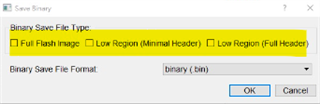

After you click one or more of the highlighted options
bin file is generated and after you can choose where to save it

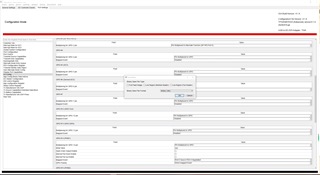

After I click "OK", the below picture is shown.
Is there something wrong of my actions?

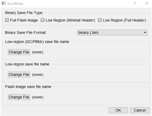

Comi,
Yes you need to click Change File and create a name for each.
If you just want the EEPROM image, you only need to select Full Flash Image.
