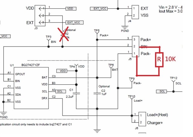

         I'd like to use external NTC on BIN pin of BQ27427 for cell temperature moeasurement.
I tried to use a 10K (1%) value resistor, connected between BIN and VSS on EVM at room temperature .
By Bqstusio the result is 18.65°C, but the internal temperature is 24.45°C.
Is this tolerance what you expect?
And I found this offset could be fixed by "EXt temp offset". It means that we need to do cailbration process for each gauge. right?

  • Hi Jonny,
                  103AT-2 NTC will be used in our project.
    So I just checked the accuracy of gauae at 25 degreeC on EVM, using 10K resistor (1%).
    And the result is what I mentiond in the previous information 18.65 degreeC vs 25 degreeC)

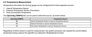

    Which thermistor do you have the gauge configured to use? Please ensure that you have the gauge configured to use the external thermistor (see image below taken from the bq27427 TRM).
    Jonny.
  • Hi Jonny,
                 The OpConfig[TEMPS] setting  is 01.

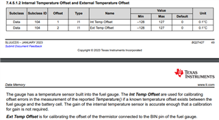

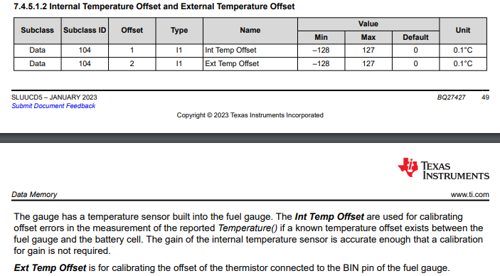

    I have discussed this with the team, and it is likely that the behavior is due to the thermistor coefficients or the external temperature offset. Please refer to the following taken from the BQ27427 TRM.
    Jonny.

  • Hello Kevin,
    Since the gap is the same between the internal and external thermistors throughout different temperature ranges, then you should be able to compensate this difference by changing the offset.
    Jonny.

  • Hey Kevin,
    As long as the offset does not exceed what is listed in the BQ27427 documentation, this should be good.
