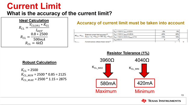

We are working on the calculator for the Hxx family of devices, however it will not be out until later in the summer. For the Hxx devices, we spec the current limit a little differently compared to the HB devices. The guidance is to take the "worst case" accuracy from the spec and use this for calculation. For example, if you wanted to set the current limit to 300mA, you would use the worst case +/- 20% value that is specified for 250mA.
A sample calculation with resistor tolerance can be seen below for a 500mA current limit:

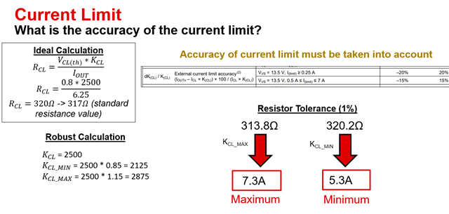

For the TPS4H160-Q1, the maximum current that you will be able to set the current limit is from 250mA to 7A. It is important to note that even at 7A, the device just clamps/regulates the current until the over current condition is removed (or the device goes into thermal shutdown).
To calculate the appropriate resistor, here is an example for your 6.25A use case:
