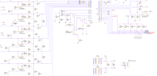

Basically I am calculating the current using 0.5m ohm shunt resistor and till the 30A the current value is accurately reading but after this value the read current value is showing less as compared to supplied current. for eg if I am giving 50A current the its showing 37A as so on. What could be the reason for it and how it can get resolved.
  • Hello Kunal,
    What was your calibration procedure for the 0.5-mOhm shunt resistor?
    If you measure the voltage drop across the shunt resistor with the current flow, does it match what is expected?
    Luis Hernandez Salomon

  • Hi Luis,
    please check the attached schematic and verify it  once.
    Also, I have attached the logs for 100A current.

  • Hello Kunal,
    Do you not have a cell attached to VC10 - VC9? The part requires VC10 - VC9 to have a real cell attached.
    The schematic seems to have 1-mOhm, not 0.5-mOhm. Which is correct?
    The log also seems to display the current at ~32000, what exactly is going on there? Do you have a .gg file of your device?
  • Hi Luis,
    Basically we have connected 2 shunt resisters of 1-mOhm in parallel which makes 0.5 mOhm.BQ76942_Calibration_settings_4S.gg.gg 1 (1).csv
    Please check the .gg file and suggest if any changes are required..
  • Hello Kunal,
    The schematic shows 2 shunt resistors of 2-mOhms, so these in parallel would make 1-mOhm. Is the schematic incorrect?
    Now. I do see that you have Settings:Configurations:DA Configuration[USER_AMPS_0] set. This means that the current will be reported in mA units. However, this means that you would only be able to measure up-to ~32-A. Because the current measurements can only go from –32768 to +32767.
    So if you want to measure currents higher than this, you will want to change the UserA settings. For example, set Settings:Configuration:DA Configuration:[USER_AMPS_1:0] too 0x02 so that your current units (userA) are in 10-mA.
    Now, I do want to remind you that the part requires VC10 - VC9 to have a real cell attached.
