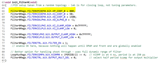

  • Hello BatMan,
    You are right that the output would be almost zero at that point. This is limited by the size of the EADC since it is only 6 bits (max of 63). Thus, you cannot have Kp = 1 since the DERR is too small. Kp must be in the hundreds, if not thousands to multiply the DERR to a large enough value. In the UCD training lab code, Kp = 800. If you just want proportional control, a Kp = 10,000 can be a good start. You can then tune it using the Fusion Studio GUI.
