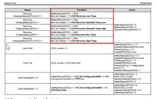

    When the COV parameters are tripped, below are the set of actions that are supposed to occur:
    As you said, the COV flag in SafetyStatus() is expected to be set, along with the CHG FET becoming disabled via the XCHG bit becoming set.
    However, I am not sure that the gauge is immediately supposed to enter shutdown since it is not one of the listed actions from tripping the protection. There could be another shutdown condition that is occurring along with the Cell Overvoltage Protection. To figure out why shutdown might be occurring, I believe I would need a .log file of the gauge entering COV.
    The actions below should allow the gauge to recover from the COV Protections:
    Anthony Baldino
