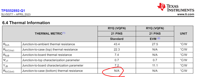

TPS552892-Q1: RthetaJC(bot)
Part Number: TPS552892-Q1
Hi Team,
I want to check why parameter here is NA?
Roy
  • Hi Roy,
    Thanks for reaching out.

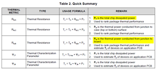

    Is there any specific requirement on this from the customer? Normally, we will not use this thermal resistance to estimate the junction temperature, because the thermal power conducted from junction to board is very hard to estimate.
    BRs,
    Bryce
