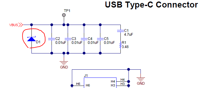

If an application with TPS65987D supports only power source(up to 20V 3A), is there no need for schottky near the Type-C connector?

The diode is recommended without consideration of the power role:
https://www.ti.com/lit/ds/symlink/tps65987ddk.pdf#page=26
