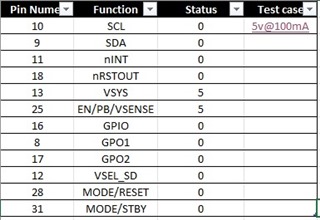

We are using PMIC TPS6521901  for powering  AM6442BSEFHAALV   .   We are in the board bring up stage but struck with the PMIC powering up . We are using 5V input and the enable pin is tied to 5V.   but PMIC is not responding . TPS6521901_pmic_Arm64x.pdf
Please see the attached schematics used .     . We tried to isolate the output rails by disconnecting the zero ohms in the o/p rails
The voltages measured at each control pin is also listed . Kindly go through the schematics and share some lights .
What shall be the minimum current  from the input supply   to start functioning the device ?  The input current is measured as 4 mA   only now .
The source current is limited to 500mA   for the test purpose (no load is connected)

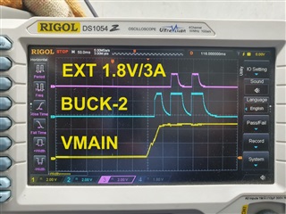

  • Hi Brenda

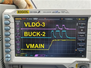

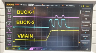

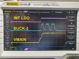

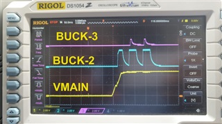

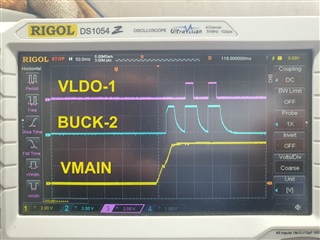

    Please see the below wave forms . All captured in 50ms time. VLDO2  is powered by external 1V8  , which is enabled by GPIO1
  • Thanks for sharing the scope captures. Here is the feedback:
    • The ramp of the "VMAIN" supply is very slow and doesn't meet the required voltage level when Buck2 is turned ON. For example, Buck2 is configured to output 3.3V and the PMIC data sheet specifies a voltage headroom of approximately 400mV to 700mV. That means the voltage on VMAIN must be at least 3.7V-4V at the time Buck2 is turned ON.
    • The output voltage on VLDO1 doesn't match the expected value. If the VSEL_SD pin is connected to a pull-up resistor, then VLDO1 is expected to output 3.3V.
    • It seems like on the second power-up attempt, all PMIC rails except LDO2 are able to ramp. Could you take a scope capture including the LDO2 input and output (PVIN_LDO2 and VLDO2)?
    Brenda
  • Hi Brenda ,
    Thanks for the comments
    • LDO2  is powered by external 1V8  . This regulator is enabled by GPIO1.. Below is the wave form of 1v8.   currently .LDO2  is not giving any output
    • VMAIN ramp up issue we are studying and update you .
    • VLDO1 issue is because , the pull up is powered from VCC_3v3_SYS  , which is now OFF   and the VSEL_SD pin  measures 0V now.

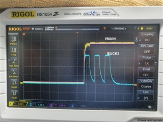

  • Hi Brenda,
    here is the update
    1. Regarding the VMain ramp up issues , we rectified the slowness still BUCK2 and other rails performance remained the same.
    2. Since the PMIC is trying to turn ON  3 times and shuts down - the reason would be any of the non maskable faults ? Are you suspecting over current  can be the reason ? Your suggestion on testing these cases would be very helpful . We are now isolating all the rails from the load and testing it.
  • I would recommend testing the power-up sequence with all the output rails disconnected from the load.
    Did you increase the current capability of the input supply based on your power analysis at the system level and the expected maximum current consumption?
    Brenda
  • Hi Brenda ,
    I would like to update the followings and get your thoughts . We have 2 boards under test
    After implementing the GPO1 pull up and correcting the external 1V8 buck output ( supply for LDO2)  , PMIC started working .
    Unfortunately in one board  while loading "VCC_3V3_SYS"  , (generated by an external Buck U17 ) is showing very low impedance and draws high current (we are suspecting short with some ICs) . This collapsed the whole system . This rail do not have any direct connection with PMIC  . This supply is used for EMMC , JTAG , and some buffers etc. After this rail loaded , PMIC started to misbehave , Not getting any outputs . It tries to turn on BUCK2 3 times and goes OFF. We isolated the "VCC_3V3_SYS external buck from the system , still PMIC  is not responding .  Please see the below waveform . No there rails are trying to turn ON . Internal LDO (pin14 ) is working .
    We need to understand how the 3.3V load is distributed between the PMIC Buck2 and the external discrete and get the full schematic reviewed by the Sitara processor team to make sure your application meets the MPU requirement listed below.
    "All signals (attached devices) connected to these IO domains must be powered from the same power source that is being used to power the respective processor Dual-voltage IO domains (VDDSHVx supply rail). A valid supply voltage for the VDDSHVx supplies must be present before any input is applied to the associated peripherals or IOs."
    How may failing and passing boars do you have? Are they all identical? Did you implement the fixes (like GPO1 pull-up, external 1.8V, etc) in all of them?
    Brenda
  • Hi Brenda,
    I would like to update the issue is resolved . Performed the  GPIO pull up fix and fixing some  assembly issues resolved the problem
