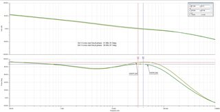

Hi TI Team,
We are using TPS65270 for one of our designs.
Below are the specs:
Vin= 7V
Vout1 = 3.3V
Iout1 = 1.5A
Vout2 = 2.5V
Iout2 = 0.5A

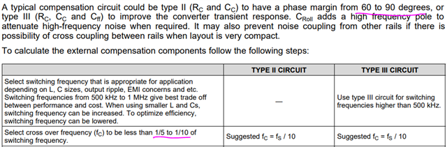

The selected switching freq. is 625k as per the ref design, We have run the phase & cross-over freq analysis. I haven't altered any Compensation circuit component, this is the same as evb ref design.
Please help to review the result, and suggest if any changes are required.
2251.TPS65270 3V3, 2V5 OUTPUT.TSC
We are in the analysis phase so, if everything is OK we will share the final schematics in this thread for review.
