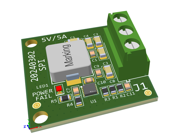

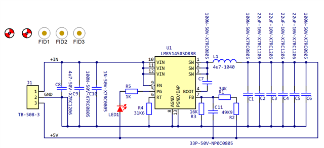

I made a pcba with the LMR51450SDRRR  a very nice chip.
But I have a problem:
Input 25V
Output 5V
Load 8R
load current 0,625A
After powered for a longer time (1 hour or so) and I toggle the 25V the chip is damaged.
I tested this issue on 4 pcba and al are damaged.
befor this test I tested al 10 pcba's  with a 5A load (5V/1R)  and every thing was ok.
So the chip can not handle power toggles at the input (what can happen in real time)
