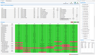

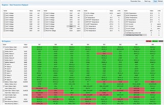

Hi Team,
I have about 10 battery packs with BMS. during my test, I understood that cell balancing for some packs doesn't work as I expected, and for some works correctly. for example, this pack has a problem with balancing.
and here is my config code
#define CELL_MAX_VOLTAGE 		0x48  //3644 //mV	 devide  by 50.6
#define CELL_MIN_VOLTAGE 		0x2D //2277mv		 devide  by 50.6 0x2d
//BALANCING CONFIG
#define BALANCE_MINVOLTAGE_RELAX    3370//mv minimmum of cell voltage for balancing in relax mode
#define BALANCE_DELTASTART_RELAX    40//mv minimmum differnce between cell voltage for balancing in relax mode
#define BALANCE_DELTASTOP_RELAX     20//mv minimmum differnce between cell voltage for ignoring  in relax mode
#define BALANCE_MINVOLTAGE_CHARGE    3370//mv minimmum of cell voltage for balancing in relax mode
#define BALANCE_DELTASTART_CHARGE    40//mv minimmum differnce between cell voltage for balancing in relax mode
#define BALANCE_DELTASTOP_CHARGE     20//mv minimmum differnce between cell voltage for ignoring  in relax mode
#define BALANCE_MAX_CELL    8   //This limits how many cells may be automatically balanced in parallel

    //////////////////////////////cell balancing configs //////////////////////////////
    // Set up Cell Balancing Configuration - 0x9335 = 0x03   -  Automated balancing while in Relax or Charge modes
    // Also see "Cell Balancing with BQ769x2 Battery Monitors" document on ti.com
    Error_flag=BQ769x2_SetRegister(BalancingConfiguration, 0x03, 1);
    if(Error_flag)
        return Error_flag;
    //Relax mode
    Error_flag=BQ769x2_SetRegister(CellBalanceMinCellVRelax, BALANCE_MINVOLTAGE_RELAX, 2);
    if(Error_flag)
        return Error_flag;
    Error_flag=BQ769x2_SetRegister(CellBalanceMinDeltaRelax, BALANCE_DELTASTART_RELAX, 1);
    if(Error_flag)
        return Error_flag;
    Error_flag=BQ769x2_SetRegister(CellBalanceStopDeltaRelax, BALANCE_DELTASTOP_RELAX, 1);
    if(Error_flag)
        return Error_flag;
    //Charge mode
    Error_flag=BQ769x2_SetRegister(CellBalanceMinCellVCharge, BALANCE_MINVOLTAGE_CHARGE, 2);
    if(Error_flag)
        return Error_flag;
    Error_flag=BQ769x2_SetRegister(CellBalanceMinCellVCharge, BALANCE_DELTASTART_CHARGE, 1);
    if(Error_flag)
        return Error_flag;
    Error_flag= BQ769x2_SetRegister(CellBalanceMinCellVCharge,  BALANCE_DELTASTOP_CHARGE, 1);
    if(Error_flag)
        return Error_flag;
    //Number of cell that we want to balancing in same time
    Error_flag=BQ769x2_SetRegister(CellBalanceMaxCells,  BALANCE_MAX_CELL, 1);
    if(Error_flag)
        return Error_flag;
    Error_flag=BQ769x2_SetRegister(CellBalanceInterval,5, 1);
    if(Error_flag)
        return Error_flag;

as you see some cells are more than 3500mv and some less than 3350 mv so delta v is more than 150mv. I have COV protection because of cell 16 voltage. but there is no act in cell balancing to reduce cell16 voltage.
here is the cell balancing time for each cell. all the parameters are 0
and sometimes work cell balancing just for a few seconds at the beginning and will stop.
i have 16s  lifepo4 battery

    What exactly do you mean by "cell balancing for some packs doesn't work as I expected"? Are you saying that cell balancing is not enabling at all?
    Do you have a .gg file of your configuration? So I may review it.
    Although it should be able to cell balance, do you know if it can balance when Cell 16 is not in OV?
    Luis Hernandez Salomon
  • Hello Lusi,
    I produced 10 battery packs (16 cells each) with a BMS. There is a microcontroller on the PCB, and I configured the BMS settings in the microcontroller. After connecting the BMS board to the batteries, I allowed them to charge to full capacity and balance.
    However, I noticed that about 4 packs were not balanced after one day. Upon reading the cell balancing status for each cell in these 4 devices, I observed that cell balancing did not occur despite a difference of over 150 mV between cells.
    I conducted further tests and found that cell balancing did not continue in OVP or relax mode. it only seemed to work just during charging.
    Based on this observation, I can conclude that there is an issue with cell balancing in relax mode.
    I can send you the configuration file (.gg )while my microcontroller configures the BMS. After configuring, I will stop the microcontroller in debugging and connect the BMS to the bqstadio.
    I put my code here again.

  • Hello Lusi,
    I have exported the .gg file
    and here is the situation of the registers:
    I didn't find the problem until now.  SLEEP_DISABLE()  also didn't change any things.
    best regards
    Alireza

  • Hello Alireza,
    Your cell voltages do not meet the cell balancing requirements in that image, did you try getting a condition for cell balance there?
    The SLEEP_DISABLE() would disable SLEEP mode, so I think it should balance there if the conditions for balancing are met.
    I see in relax mode you have a Minimum Cell Voltage of 3370-mV to start balancing. And a minimum cell voltage delta of 40-mV. So I'd expect balancing would start at roughly 3.41-V or so.
