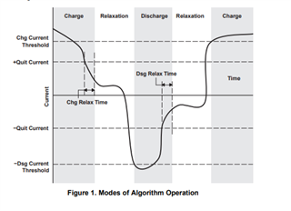

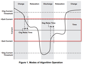

    I believe the image below can be helpful in explanation:
    Relax mode is a state where the cell is neither being charged or discharged, and is normally where the gauge takes a large sum of its measurements. To enter Relax mode from either Charge (where the current on the sense resistor is greater than the CHG current threshold) or Discharge mode (where the current on the sense resistor is less than the DSG current threshold), the current needs to be less than the Quit Current but greater than the -Quit Current seen in the range below:
    If the gauge is in Charge mode and is attempting to enter Relax, the current needs to stay in that range for at least the time depicted by the parameter CHG Relax Time.
    If the gauge is in Discharge mode and is attempting to enter Relax, the current needs to stay in that range for at least the time depicted by the parameter DSG Relax Time.

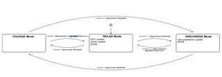

    This depiction below can also help:
