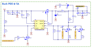

I've designed the PCB with TPS65988. Port 1 is used to sink power upto 100W. This part is working well. However, Port 2 is used to source power to iPad (as a charger). But in this case, supply only 5V 900mA.
It's never negotiated for higher voltage or current value. Please help me to fix this issue.
I've attached my PD schematic and GUI tool project file here. Please somebody help me.
GUI Project  TPS65988_UPF_DRP_Latest.pjt
Schematic: PD Sch.pdf
