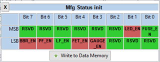

I cannot get the status LEDs to illuminate under any condition other than sending LED toggle, in which case all LEDs illuminate as expected. The client wants LEDs to illuminate during charging and when the pack is turned on.
Nothing illuminates during charging, although the battery % displayed on BQ studio seems off and intermittent so I suspect it hasn't calibrated correctly, despite selecting the correct chemistry and running a learning cycle. (Qmqx for cells 1 and 2 seems to have been set, for the unused cells 3 and 4 it obviously didn't change, but is still 4400mAh, should I clear this? Qmax pack seems correct. The pack is currently charging. No LEDs and BQstudio shows 0% charge despite it being 7913mV (2S 18650)
I cannot get the LEDs to illuminate upon exit of reset either. I suspect it may be the same issue and the chip for some reason always thinks it is empty so it IS "illuminating" 0 LEDs
The board does not utilize the DISP button, so the pin is connected to VSS, so unfortunately I cannot test it that way, and, sending DISPLAY_PRESS from BQ studio does nothing.

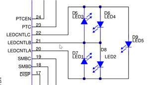

    Just to confirm, are the LEDs that are being used set up in the same configuration as below or differently?

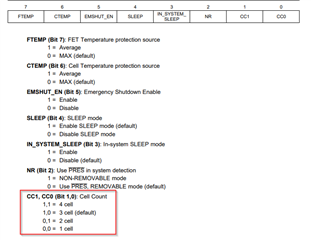

    I believe for cell configuration, the most important parameter to change is DA Configuration, which can be done in bqStudio in this register:

    I am going to start fresh on a second control board. Did you find anything in the gg file I sent? It should have CC1 = 0 CC0 = 1 for  a 2 cell pack and I have done the ChemID as well as a learning cycle with no luck, that's what led me to ask here.

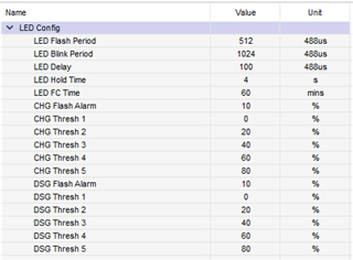

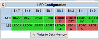

    Also within the LED Configuration, can you please confirm that LEDC0 and LEDC1 are configured correctly for the LEDs you are using?
    Anthony Baldino
  • Yes, they are configured the same (this schematic has A,B, and C in reverse order on the chip, but the connections are correct)
    LEDC0 and LEDC1 are both 0. The LEDs all illuminate correctly when the LED toggle command is issued, but never otherwise. Even if LED_EN is set.
