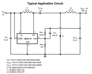

LM2611 function can meet Vin: 12V to Vout:-12V/0.1A?
if possible, please suggest surrounding R/C part value.

LM2611 is capable of this application. Please note that the max input voltage is 14.5V.
I would suggest to use power stage designer to determine the L/C values.
