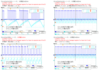

  • Dear Shipen Cheng, Thank you for your reply.
    Transmit the data by changing the inductance.
    Simply changing the inductance to 3.3uH did not resolve the abnormal operation (intermittent oscillation).
    The continuous oscillation phenomenon was also observed at 22uH when the direction of L1 was reversed.
    At this time, the output voltage became higher than the set value (5.5V).
    After this, I changed the type of inductor, but in this case the output voltage was 5V and good results were obtained.
    However, the reason is unknown.
    ③L1=3.3uH (VLS-EX series), L1 direction = positive direction, load current = 800mA There is abnormal operation (intermittent oscillation).
    ④L1=3.3uH (VLS-EX series), L1 direction=reverse direction, load current=800mA Although it is continuously oscillating, the output voltage (setting = 5V) has become approximately 5.5V. →NG
    ⑤L1=3.3uH (SPM series), L1 direction=positive direction, load current=0mA There is abnormal operation (intermittent oscillation).
    ⑥L1=3.3uH (SPM series), L1 direction=reverse direction, load current=800mA Currently, this is the best.
    *VLS-EX series TDK VLS5045EX-220M
    *SPM series TDK SPM4020T-3R3M-LR
    It turns out that inductor noise is caused by the orientation of the inductor.
    I found the following material on the TDK website.
    This indicates that a large amount of magnetic flux is leaking in only one direction of the inductor.
    In this evaluation result, the characteristics were better when the side with more magnetic flux leakage was facing the IC.
    Conversely, if the side with a lot of magnetic flux leakage was placed on the opposite side of the IC, the characteristics were poor.
    Can you guess from this what the cause is?
    thank you.

  • Due to the nature of the product, we cannot make major layout changes, so we would like to take measures such as making small changes to parts.
    We will send you materials with added comments showing the surface with a lot of leakage magnetic flux and the positional relationship with the IC.
    As I wrote in the previous post, the results of this evaluation showed that the characteristics were better when the side with more leakage magnetic flux faced the IC.
    On the other hand, if the side with a lot of leakage magnetic flux was placed on the opposite side of the IC, the characteristics deteriorated.
    Can you guess what the cause is from this?
    thank you.

  • There are two reasons to ask.
    ① I want to know the cause of abnormal operation.
    ② I want to confirm that it is working properly.
    Although it is possible to verify ② using an EVM board, the purpose of ① cannot be achieved.
    If the problem is not resolved by ①, we will check because ② alone cannot solve the problem.
    Can you deduce the cause of the current abnormal behavior and which part of the IC is affected and how?
  • Hi smash,
    The device determines the switch-on time rely on sensing the SW pin and FB pin voltage. So for a correct behavior, the SW voltage sensed on the pin should be close to a square wave and the FB pin should really reflect the output voltage. If there are long wire out these two pin, noise will be coupled, which will cause a wrong switch-on behavior, it means the high-side MOSFET may turn-on at a wrong time.
  • To increase the noise immunity of the FB pin,
    Is it effective to change to "R1=3KΩ, R3=4.3KΩ, R5=1KΩ"?
    Also, are there any possible disadvantages in this case?
  • Hi smash,
    Yes, it can be useful. The only disadvantage is lower efficiency in light load.
    Thanks.
