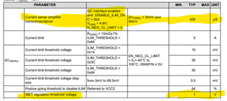

  • Hi Xiaoshan,
    please see the marked lines from the datasheet:
     Stefan
  • HI,
    In both equations below:
    • V(ILIMCOMP) = [V(ISNSP) - V(ISNSN)] × gm(ILIMCOMP) × R(ILMCOMP)
    • V(CDC) = [V(ISNSP) - V(ISNSN)] × gm(CDC) × R(CDC)
    V(ILIMCOMP) = V(CDC) = 1V, and gm(ILIMCOMP) = gm(CDC), therefore, R(CDC) should have the same resistance value as R(ILIMCOMP), right?
    I also have another question: Is it appropriate to set the value of I(ISNS) equal to Iout(MAX) = 6A?
    Thank you very much!
  • Hi Xiaoshan,
    Right for that both will have the same resistance.
    Yes, this can for sure be done. So you would limit the output current the the max current you have used for the design of the power stage.
     Stefan
