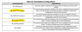

    Yes this can be done. What I recommend is for the Dual-Power port A have the PP Switch configured as 'PPx configured for Sink (input) and Source (output), but will wait for SYS_RDY command (SRDY) before closing the switch.'
    This way the MCu will control when to turn on/off the power-path. There is a potential system design issue with this though:
    Use Case 1:   The device is powered from VBUS only, port A sinks, port B sources
    For Use Case 1, if the MCu is powered from PP_HV1 <-> Port A, but the TPS65988 will NOT turn on the sink switch because MCu needs to send the 'SRDY' command. This will lock up your system when booting from dead-battery. To avoid this, there are 2 options:
    1. it may be good to see if the MCu can boot from the LDO_3V3 output of the PD controller but be careful not to exceed the current rating for LDO_3V3.
    2. Configure the ADCIN to be in one of the highlighted configurations to enable the sink path at boot regardless of the SRDY command in dead-battery mode. This could be problematic since Port B could also turn on and become the sink path but once configuration is loaded, it will default to Source and reboot continually.
