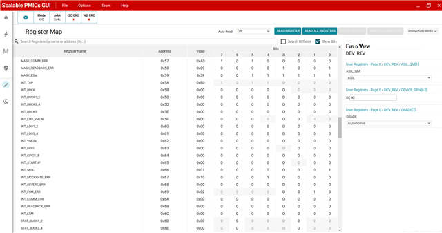

Hello PO CHUN,
Can you do me a favor, if you're able to give me a screen capture of your registers, like this?
I want registers 0x5A to 0x6C, before you try to enable either BUCK1 or BUCK5, thank you!

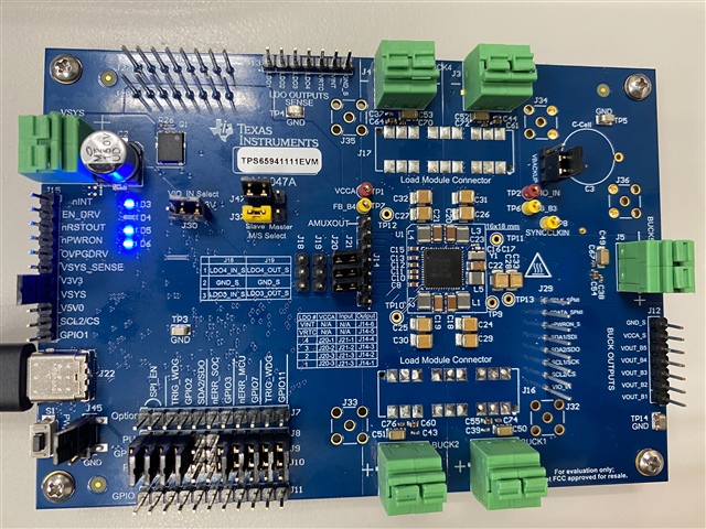

Pls check the setup photo:
I'm sorry this link doesn't work and will not be viewable through our proxy, could you post directly to the forum through an upload?

Hi Nicholas,

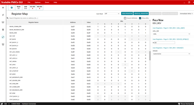

Below is default Register setting:

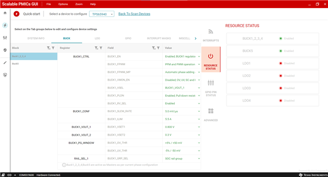

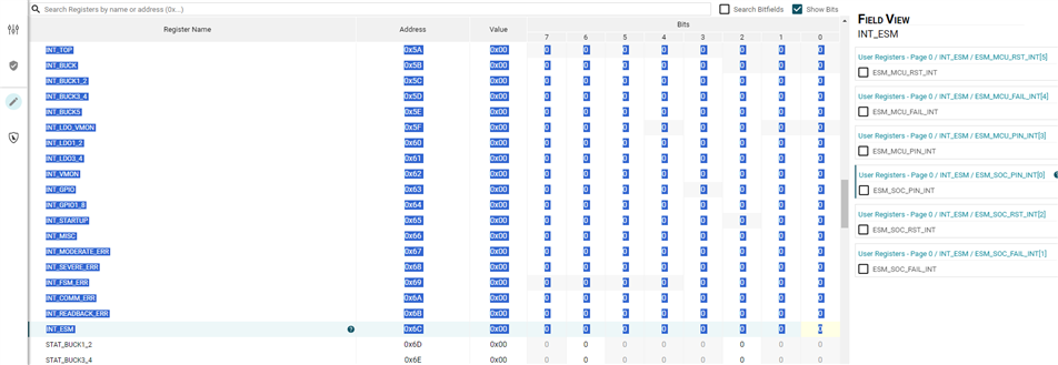

And next is enable BUCK1 and BUCK5:

The interrupts indicate that there's an SPMI error (on register 0x67), which makes sense because the TPS65941111 is to be used in the secondary position in a multiple PMIC setup. It will not be able to turn on the BUCKs until this error is cleared which it won't until it is connected to the appropriate TPS6594. This is a bundle of the TPS65941212 & TPS65941111.
Are you to make your own programming or are they looking to just turn on the BUCKs for evaluation purposes?
