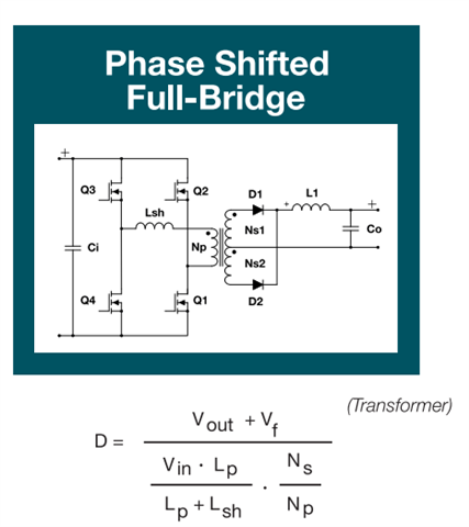

UCC28950EVM-442: Need help to design Shim Inductance to design 4KW Phase shift full bridge Converter
Part Number: UCC28950EVM-442
We designing 4KW Phase shift Full bridge converter for below specification,
Input voltage -38Vdc-60Vdc,
Input current -126,
Output voltage -200V,
Output current -22A
Switching Frequency -250kHz
To calculate shim inductance I used formula which is given in this reference design www.ti.com/.../slua560
but  getting 1.4nH .I think,it is wrong value.
Kindly help me to design Shim Inductance and procedure for above  spec.
