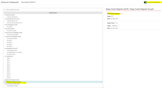

  • Hi Chen,
    The I2C issue is related to the EVM, it does not support the BQ controller you are using.
    I found another setting that affects the current draw.
    Please try these binaries, I think they should resolve the leakage current issue.

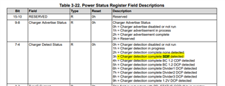

  • Hi Chen,
    Would it be possible to obtain a I2C log of the traffic between the PD controller and BQ25792 when the usb-c cable is connected?
    Specifically, I want to see if there are any writes to reg0x06,Input Current Limit.
    Because we hard set the precharge to 400mA, the BQ needs to limit the power draw from the input side. We need to check to see what value the PD controller is updating with.
    Also, could you check and report the status of these bits when the system is hooked up and drawing power?
    Thanks and Regards,
    Chris

  • Hi Chen,
    1. Are you still acting as sink in this case? Can you confirm from register reads of the Power Status register and make sure a BC1.2 contract is entered? What do you mean by "It still have more power pulled from USB2.0 and similar legacy port"? Is a power limit hit during testing?
    2. In the GUI, enable Advanced Config and navigate to the "Sleep Control Register". Select the Sleep Mode Enabled field to enable the lower power mode for the PD controller.
    You can share the json and binary here by just dragging the files into the reply, I attached the files you shared below.

  • Hello Chris:
    Thank you for your reply. I made some changes to the BIN file and tested.
    1. Yes, it is SINK only. After the BIN update, we can see all 6 PDOs, including 5V/0.5A, 5V/3A, 9V/2A, 12V/2A, 15V/2A and 20V/2A. However, 5V/0.5A is not really working, and it still overdraw current from USB2.0 port. When plug into old laptop, it would alert the error on the USB port, and measured as 1A, which is double the standard 500mA.
    2. Leakage current issue is mitigated after "sleep mode" is selected. During the test, we noticed the active time is relative long, but overall it is much better than before.
    3. In the configuration, the precharge current is set to 120mA. However, it is always 400mA during precharge. Could you help to check?

  • Hi Chen,
    Could you reshare the old 25750 file. I'm not sure about the leakage current but can look into the 500mA setting. From checking with the team though, it seems like the 900mA option is the only one.
    If we want to use the MCU to control, could you share the details of the programming? We can just use the I2C_Slave pins to control that? How the IC identify the legacy protocol, and what is the address and command for this control? Is it simply the charging current settings?
    You would need to check register 0x3F (power status) in the PD controller and read teh connection and TypeC Current. If it is option 0x0, USB Default current, you need to program the BQ source current limit to 500mA.
    Chris
