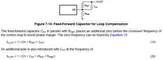

I have some questions about the Cff value on the EVM, and the pole/zero values that go along with it.
When I use datasheet Eq 21 I get 59.4pF for Cff based on the other EVM values and using Fx = 48.8 kHz (per the EVM specs of 3.3V output, 150uF Cout and K = 24.16)
I think this value of Cff makes sense given I'm using Fx = 48.8 kHz, and in this other post you had used 10 kHz. (e2e.ti.com/.../tps7h4010-sep-cff-calculation-guidance
For 59.4pF the corresponding zero and pole frequencies I calculate are:
Fz-Cff = 26.8 kHz
Fp-Cff = 1.156 GHz
Are these zero and pole frequencies reasonable, given the intent of Cff?
Thanks for your help.

  • Hey Jim,
    These are the equations for the pole/zero locations:
    R1 being the top resistor and R2 being the bottom.
    This gives ~24 kHz for the zero and ~80 kHz for the pole (R1 = 100 kOhms and R2 = 43.2 kOhms)
    The pole/zero locations should have a geometric mean around the crossover frequency.
    My numbers here give ~44 kHz
    Daniel
  • Thanks Daniel
    Your equations above helped me identify an error in equation 20 in the datasheet.
    Equation 20 has Rfbt / Rfbb, but should have Rfbt // Rfbb.  Can you get this correction in queue?
    Instead of showing the // symbol we could update equations 20 and 21 to show the actual parallel calculation details. This might avoid confusion for folks who aren't familiar with the // notation, or who just miss it when reading the equation.
    Jim B
  • Hey Jim,
    Thank you for the note.
    Ill work internally on corrections.
    Daniel
