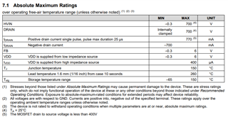

Does UCC28881 do HTRB or H3TRB test? If not, how to evaluate the reliability of internal high voltage Mosfet? Thanks!

I have confirmed with our experts that HTRB test conditions was covered under HTOL which UCC28881 was tested under.
Hi Claire,
Thanks for check. HTOL is a qualification which is included by most of TI devices. In HTRB test, a VDS ramp test, as the drain-source voltage is stepped from a low voltage to a voltage that’s higher than the rated maximum drain-source voltage. Customer wants to know the specific test condition for UCC28881 to ensure 700V voltage rating. Thanks!

For Flyback. Customer is wondering the safety certification to ensure the internal Mosfet could bear 700V voltage rating. They are curious and strict about component evaluation.
what specific test conditions you would like to know?
For example, what is the maximum drain-source voltage applied to the internal Mosfet? And unfortunately I'm not quite familiar with the test procedure, I don't know whether there are other more specific test condition. If you team could provide this info, it will be very helpful.
