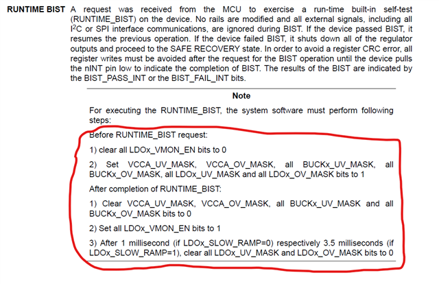

Hi Colleagues,
How long does the runtime bist and the boot bist take?
Are they performing the same routines, LBIST and ABIST? according to the datasheet ABIST and LBIST run in parallel, which means that the longest time it takes to complete is the max LBIST time as this is the longer one. can you confirm this?
BR Simon
