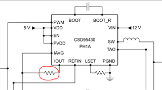

Base ont the datasheet, all paralledled phases should have a 1K resistor from IOUT to the controller.
Question: this 1K resistor is must or not? Thanks

It is a must if paralleling is used.

1. and could you share the reason why it is needed when paralleling.
2. What will it impact without this 1K resistor when paralleling?
Best Regards
Lisa
When paralleling, IAVG is compared to IOUT. The voltage drop across the 1K adjust the duty cycle and makes IOUT = IAVG. Without the resistor, IOUT is always equal to IAGV and the imbalanced current can not be adjusted.

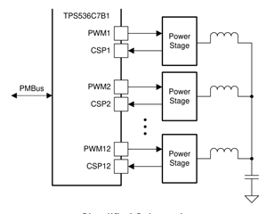

Hello Mahmoud
Thanks for your reply.
Another question is if 1 Phase only connect 1 power stage like below picture showing. this 1K resistor is not needed, right?
