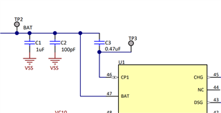

Our customer proposed a question that will it lead to any issue if the C connected to CP1(Pin46) beyond the recommending value?
C3 as the above picture, is there any risk if the Value above 0.47?
Hello Jingguo,
There is no risk. We recommend up-to 2.2-uF for this capacitor.
Beyond this value, we cannot warranty everything will work properly. However, I would expect the only thing that could happen is that the charge-pump turn-on would be slower.
