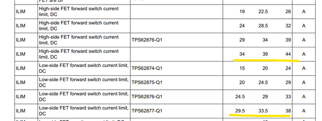

May I ask whether TPS62877-Q1 can support 30A continuous output at Full temperature(-40~125°c)?
Because from below Lowside FET parameter, the current is only 29.5A. Thanks a lot!

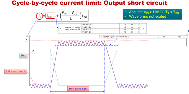

Hi Daoyan,
The low-side FET forward switch current limit parameter indicated in the table above is only applicable when the high-side FET reached the forward switch current limit first. When it happens, it turns off the high-side FET immediately and turns on the low-side FET after some delay. As the inductor current is ramping down, the low-side FET turns off once it reach the current threshold to prevent inductor saturation. Please refer to sec. 8.3.14 of the datasheet for the detailed description or in the figure below.
So, TPS62877-Q1 can support 30A of load current depending on the mission profile of the application.

Thanks for the explain. May I add another ensurement?
According to TPS62877 datasheet 8.3.14 over current protection, may I understand like this: "Only when the HS-FET exceeds the Limitation, over current protection will be triggered. If HS-FET does not exceed the limit, only the low side exceeds its limit, the OC protection will not be triggered, right?
